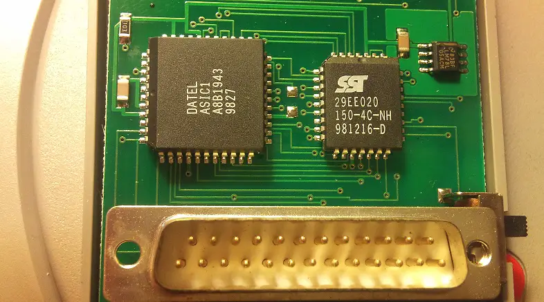

                    Ran a vm box of Win XP 32bit because the ar3stop executable refuses to run on a 64bit OS. After patching it changed the file size to 512KB which will not fit onto my EEPROM since It's only 256KB.
                    SST 29EE020 (EXPLORER) - 256KB

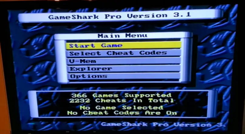

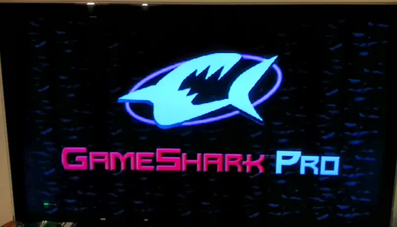

                          Finally, after several years, I got the time (and equipment) to dump my GSPro 3.1 ROM.
                          I used a Windows XP SP3 (32 bits) computer, with motherboard with built-in parallel port. I repeated the procedure 2 times for each BIOS configuration (Normal, ECP, bi-directional; EPP didn't allow the connection to get through) and I'm happy to say all dumps had same checksums (CRC32, MD5 and SHA-1).
                          I used AR3FLASH CD 0.30 along with AR3FLASH tools 0.32. Dumped with following command:
                          ar3bkup gspro31.rom
                          Anyone willing to flash this in their GSPro cart and confirm it's working?
                          https://mega.nz/#!dA11UYKb!tELSwBz9L...b7bOJ35opOOJ1A
                          Once extracted:
                          file: gspro31.rom
                          CRC32: 94313B12
                          MD5: 7E36E840DC1976CFA7FE35D0423C7420
                          SHA-1: 14FF71FFB2498F1671E555133765F9EFB2DEA950
                          FYI: I got this cart lose/used several years ago from eBay. Knowing it was never dumped, I never used it or 'wrote' to it. I never even checked if it had codes/saves from the previous owner.
                          Couple of pictures:
ID:	162880Click image for larger version
