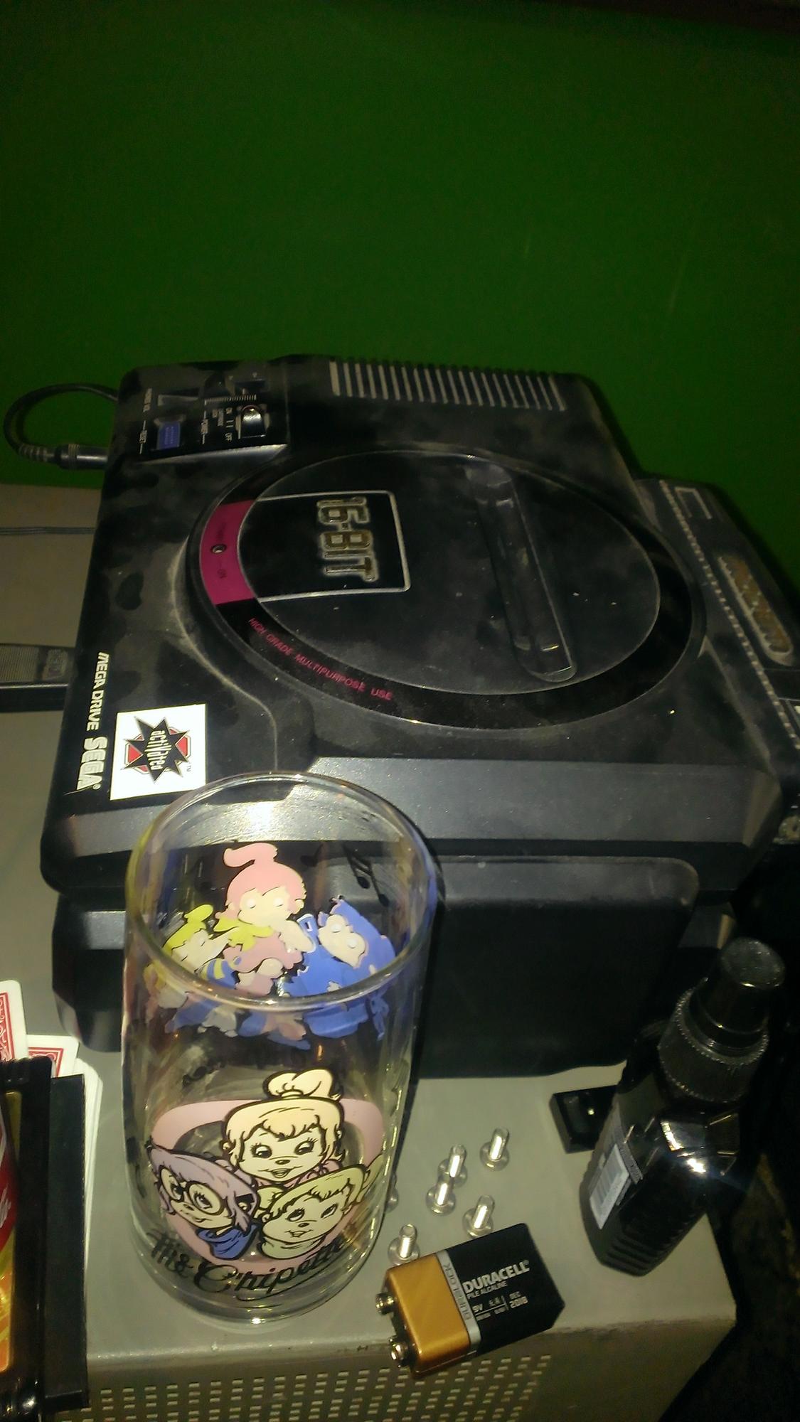

      Anyway, my console is a Japanese Mega Drive...

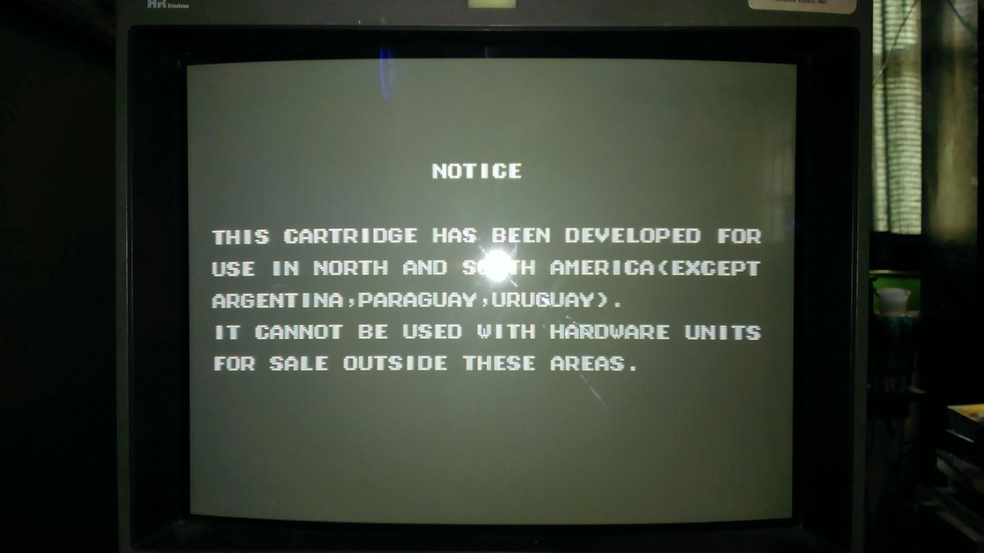

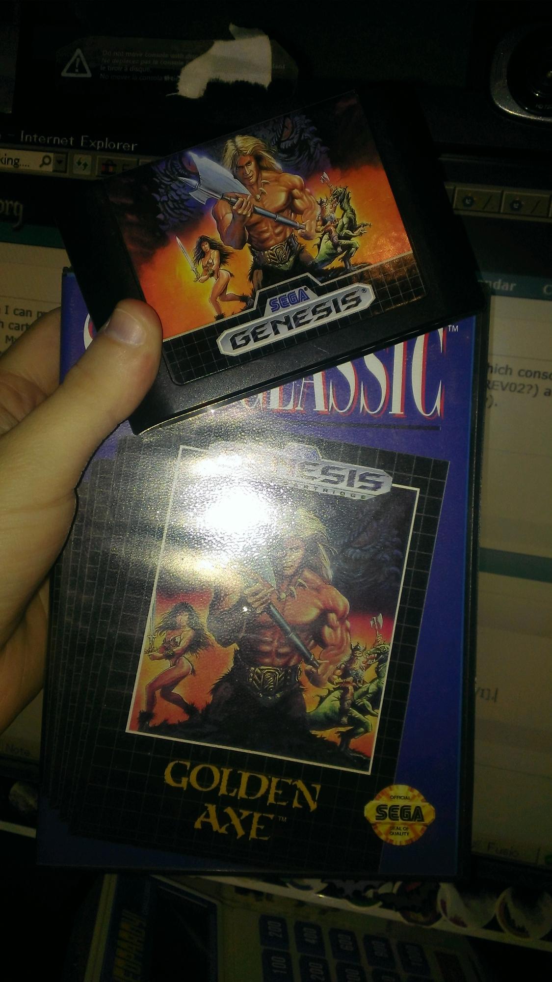

      ...attempting to run the Sega Classic release of Golden Axe.

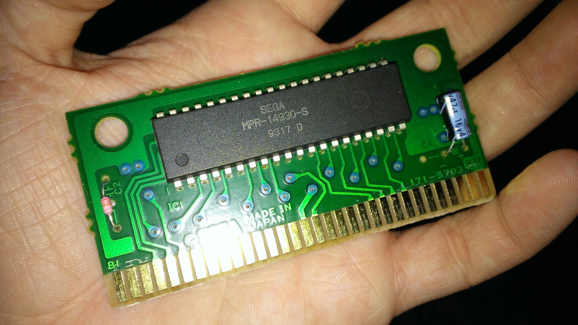

      This is the ROM board inside the cartridge:

              Tested and works on real hardware.
              REGT-A6ZE
              Lets you play the US cartridge on a Japanese Mega Drive console.
              ETFT-AA24
              Master code (this gets rid of the blank/red screen).
