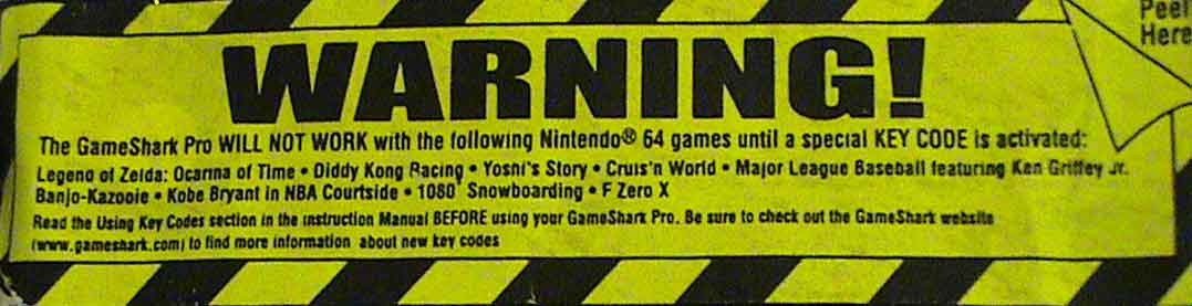

    one problem with GS n64 you need super mario 64 and keycode for zelda
    or zelda will corrupts GS
    Never knew that. Thanks for the heads up.
    Before the one I had (GS) stopped working I did have SM64 codes in it and I own the game, well both of them and Smash Bros.

      GS N64 WARNING STICKER
