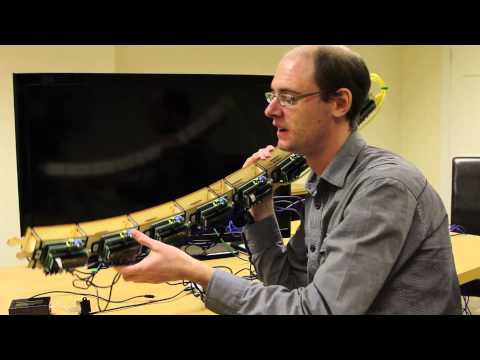

This tiny, inexpensive device has been doing wonders around – just a few days ago we saw howRichard Garsthagen was using it as a full body 3D scanner. Now, a team of extremely creative people have created a really inexpensive bullet time set-up using Raspberry Pis – and the whole set-up costs less than a professional DSLR camera.
Folks at PiFace have created an inexpensive rig which looks more like the LHC at CERN using nearly half a kilometre of network cables, 48 Raspberry Pis fitted with cameras and PiFace Control.
The rig worked perfectly – in terms of doing what a bullet time set-up should do. Raspberry Pis achieved the Hollywood’s ‘frozen time’ affect at a much lesser cost.
Check out this video.
Here is a quick list of hardware used to create this set-up.
The set-up opens new possibilities for film-makers with tight budgets to get ‘Hollywood’ effects using Pi's.

- 48 Raspberry Pi Model Bs
- 48 Raspberry Pi Cameras
- 48 PiFace Control and Display
- 48 NOOBS SD cards
- 48 5V PSU
- About half a kilometre of network cable
- 2 x 24 port switches
- 1 wireless router
- Custom laser cut frame
- Enough extension cables plugged into a single socket to scare most caretakers
- Python script listening to receive command to take picture (included in snap-camera package) https://github.com/piface/snap-camera
- Python script to collect images over network and assemble frames in order.
