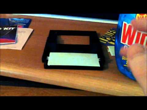

Fixing Your Old NES & Maintaining Your Games
If you have an NES with connector problems, it can probably be repaired, and you might even be able to do it yourself. Check out iFixit's repair guides for some common fixes, including a relatively easy one - fixing the springs that hold up the cartridge slot. While mine never broke, I had a bunch of friends with dead springs. We can fix it!
And when I asked Viturello about cleaning cartridges, he told me:
Viturello: "The best methods for cleaning game cartridges are: isopropyl alcohol and swabs or, more recently I and others have discovered that non-conductive metal polish such as Sheila Shine or Brasso is very effective and also helps to protect against some of the elements that would otherwise cause that natural tarnish that occurs through regular exposure to the elements and standard usage."
