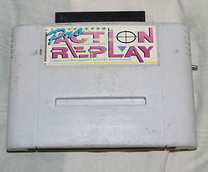

SNES Pro Action Replay Manual

                does anyone have the pdf of pro action replay snes manual?
                  Yes. Does it have to be pdf? I have it in plain text. I'll post it as soon as I find it.
                  EDIT: Here it is:

                    I found very rusted AR for SNES, surprising its still work fine
                    right I trying remove the rust

                              I'm interested, how to use the trainer part of PAR SNES
                              this version I got
