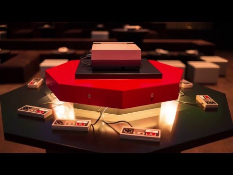

The 8 player NES in all its glory, upon a custom made octagonal pedestal.

First things first: the team used a real NES with real game cartridges. There was no hacking of the console itself, nor of the game ROM's. Everything that you see in the photos and videos was created with DIY hardware and software.
To connect eight controllers to the NES, they used an Arduino-based multiplexer. Video output from the NES is fed through an upscaler, to get the output up to a solid 576p at 50Hz. Audio output goes directly from the NES to the room's sound system.

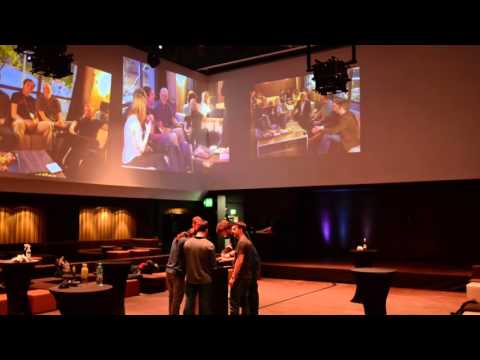

Next, the upscaled video is fed into a "tracking PC." This PC is running some custom software that takes incoming video frames and copies them into a new, much wider output buffer. The software looks at the background of each frame as it comes in and tries to line it up with the previous frame, stitching them together into a panorama. This sounds quite simple until you remember that a) the background can move very quickly or slowly, depending on the player, and b) in most side-scrolling games the player can also go backwards.
Once the tracking PC is done working its magic, the video output is sent to a media server, which in turn drives eight projectors (two for each wall). Because each wall has a slightly different aspect ratio, and the media servers stretch the output image slightly to cover the entire space, the tracking PC also has a real-time "GPU algorithm" to correct the distortion. The end result, as you can see throughout this story, is a very sharp rendition of Super Mario Bros, Castlevania, and other NES classics.

The final piece of the equation is turning original one- and two-player NES games into cooperative eight-player games. The Arduino multiplexer has two modes of operation: it either cycles through each gamepad after a fixed amount of time; or the tracking PC can tell the Arduino to change to a specific gamepad, depending on how far through the level the players are.
So, for example, Super Mario Bros might switch between game pads every five seconds, or every time Mario moves a certain distance towards the end of the level. With eight players arranged around the octagon, you could arrange it so that each player gains control of Mario when he's on their section of the wall.
