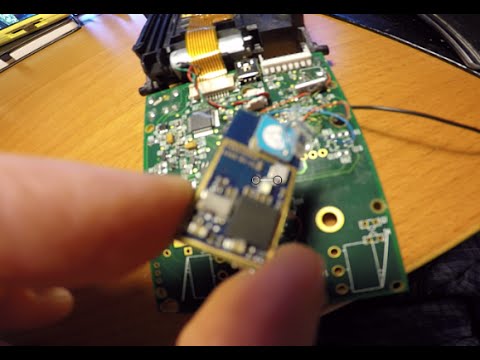

Turns out, Free2Move is the default name for a bluetooth beacon in a component made by a legitimate wireless communications company of the same name. I also located a sales thread in a dubious looking site that specializes in offering this technology in mini form for ATM PIN pads and card readers for $550 per component (although the site claims it won’t sell the products to scammers).
The Bluetooth circuit boards allegedly supplied by the Eastern Europeans who bribed my source’s technician were made to be discretely wired directly onto the electronic ATM circuit boards which independently serve the machine’s debit card reader and PIN pad.
Each of the bluetooth circuit boards are tiny — wafer thin and about 1 cm wide by 2 cm long. Each also comes with its own data storage device. Stolen card data can be retrieved from the bluetooth components wirelessly: The thief merely needs to be within a few meters of the compromised ATM to pull stolen card data and PIN's off the devices, providing he has the secret key needed to access that bluetooth wireless connection.
Even if you knew the initial PIN code to connect to the Bluetooth wireless component on the ATM — the stolen data that is sent by the bluetooth components is encrypted. Decrypting that data requires a private key that ostensibly only the owners of this crimeware possess.
These are not your ordinary skimming devices. Most skimmers are detectable because they are designed to be affixed to the outside of the ATM's. But with direct, internal access to carefully targeted cash machines, the devices could sit for months or even years inside of compromised ATM's before being detected (depending in part on how quickly and smartly the thieves used or sold the stolen card numbers and PIN's).
