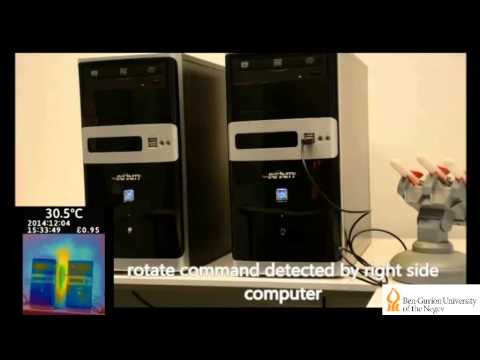

But security researchers at Ben Gurion University in Israel have found a way to retrieve data from an air-gapped computer using only heat emissions and a computer’s built-in thermal sensors. The method would allow attackers to surreptitiously siphon passwords or security keys from a protected system and transmit the data to an Internet connected system that’s in close proximity and that the attackers control. They could also use the internet-connected system to send malicious commands to the air-gapped system using the same heat and sensor technique.
In a video demonstration produced by the researchers, they show how they were able to send a command from one computer to an adjacent air-gapped machine to re-position a missile-launch toy the air-gapped system controlled.

The attack, which the researchers dubbed BitWhisper, uses these sensors to send commands to an air-gapped system or siphon data from it. The technique works a bit like Morse code, with the transmitting system using controlled increases of heat to communicate with the receiving system, which uses its built-in thermal sensors to then detect the temperature changes and translate them into a binary “1” or “0.”
To communicate a binary “1” in their demonstration for example, the researchers increased the heat emissions of the transmitting computer by just 1 degree over a predefined time frame. Then to transmit a “0” they restored the system to its base temperature for another predefined time frame. The receiving computer, representing the air-gapped system, then translated this binary code into a command that caused it to reposition the toy missile launcher.
The researchers designed their malware to take into consideration normal temperature fluctuations of a computer and distinguish these from fluctuations that signal a system is trying to communicate. And although their malware increased the temperature by just one degree to signal communication, an attacker could increase the temperature by any amount as long as it’s within reason, to avoid creating the suspicion that can accompany an overactive computer fan if the computer overheats.
Communication can also be bi-directional with both computers capable of transmitting or receiving commands and data. The same method, for example, could have been used to cause their air-gapped system to communicate a password to the other system.
