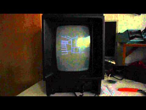

You can see the Vectrex version of Bad Apple below, along with a 3D-engine based on Doom levels. The engine is written in C and makes use of the Z-buffer, creating the effect of solid 3D-objects in front of each other. There are no weapons or enemies to dispatch here, but the effect is impressive nonetheless.
